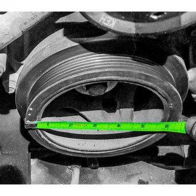

I do have a question though - the 15% is with the 5.7 damper, are the 5.7 and 6.4 stock dampers the same diameter?
The parts breakdown (online) shows 2 different dampers for the 6.4 - one is the same as the 5.7, the other appears to be a dual belt damper??? Does the 6.4 come with dual belts?
Good info, thanks. Agreed, Im running probably right around 15% higher then stock rpms so it'll be near perfect balance.
On the dual belts, mine is a single belt and I've only seen the damper that was for the 5.7L. I was sure they would be same, so much is. Half the gear I've purchased in the last month says 5.7l on it. I gave out early on the search, I sent out a couple emails to confirm, none replied, So I came here to confirm.
I guess I'm getting at my knowledge on the front system is limited. I can mic the stock damper here shortly and will post results. The only possibility I can think for the 6.4 dual belts is maybe for the dual alternator set up. But I've never seen it and only read very little about it, so Nothing more then expanded search criteria, maybe. Lol

Definitely a single belt damper on my 6.4, I hacked out a measurement of 6 5/16" or 130mm. 130.33mm but my margin of error is well over the .33mm distance. 731d0777617caf2d5d5ad8798eb6dcb8.jpg
