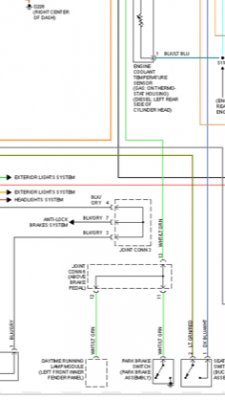

The whole pic won’t upload but I googled 2006 dash electrical schematic and found it in images.
