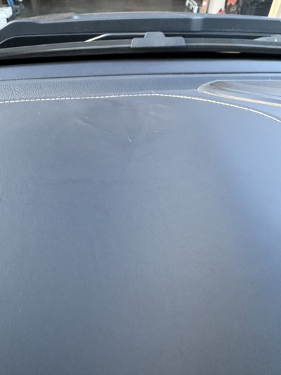

OK, i found some time, but, i should have waited and not rushed. It came out OK, but not 100% I probably should have put more glue around the inside edges. Once I injected the glue i tried to spread it around using a micro fiber rag.
I found it was easier to pull the plungers out of the needle body and squirt the glue in, then replace the plunger. Be careful, i did poke myself twice. Maybe when it get warmer next spring i'll do the small parts again and see if i can get it flat 100%

Not to bad of a job in my opinion. Waiting patiently to see the final results after you completely finish. So far so good and I hope the adhesive holds up.
