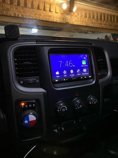

installation in these trucks is a breeze. there’s a pretty decent amount of room behind the radio. I wouldn’t pay a company to do it unless you just prefer to have someone else do it for warranty purposes.
I used the metra dash kit for like 15 bucks. I think all in, with the $150 harness, i’m still under $450 total on this install
