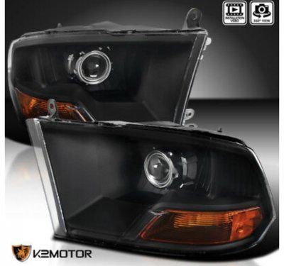

Can I use these and set the turn signals up as DRLs? Would it work?
