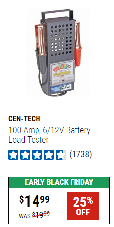

Everybody needs one of these old school toaster style battery load testers in their tool boxes. Simplicity onto itself to use,and will give you the best indicator of how your battery is doing with-out breaking the bank to purchase.
That's a good idea. Order placed. Thanks for the link.

No worries,it will smell a bit when you use it the first couple times,and will get warm,as they basically operate like your household toaster does
I'm going through a suspected battery issue and got the HF version for $15 yesterday. Did a couple of parts stores with the fancy digital version and almost dead on. I even took a shot battery and the results were pretty dang close.

Forgot about this post. With the 3 part stores testing and mine with the tester both batteries check "good". Went to WallyWorld and got 2 EveryStart platinum AGMs for $170ea. Been through a few -0° nights, with putting them on trickle overnight, no starting issues. The Diesel & DEF during those times were a different story
