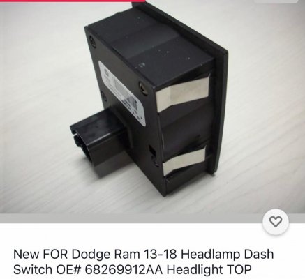

I see the OEM headlight switch 68269912AA is a modular unit that slides in from the front with four spring tabs on the side.
Any tricks on releasing the tabs to remove the switch?
EdGs
Nov 29, 2020
5,450
11,568
FL
Had to replace the HL switch on my 2015 1500 (no fogs on mine). My lights would be on even at running lamps only position. Had to switch to auto to shut them off.
Use a plastic trim tool to pop the module out.
5 minutes to swap out.

Got a new switch module on order. Thanks for tips. [emoji1695]
I popped the new switch module in and the fogs work. [emoji1303]
I took the old one apart but didn’t see anything obvious.
FYI I got a good deal on an unbranded but identical module. I received a Mopar OEM part. [emoji2]
