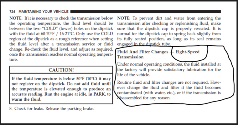

2016 1500 Ram Bighorn, 5.7 8 speed trans. 117,000 miles. First post here, I called local dealership for price on tranny fluid and filter change. They ask if I was having problems, I said no. Well they said for my PU the fluid and filter is for Life time, unless there is a problem they won't change it. I said nothing is life time and it ended. How true is this, Life time? I don't haul anything, no slippage, just thought it should be serviced. Thank you.
I’m sure it’s probably already been said at this point but yes, if you look up the manufacturer of these eight speed transmissions, you will find that there is indeed a maintenance interval but that’s strange your dealership told you they wouldn’t touch it because when I asked my dealership about it several years ago, they told me the same thing about it being a lifetime fill but they did say that if I wanted to change the fluid and filter/pan in it, it was gonna cost me about $600 to service it.
If you’re mechanically inclined, you can do it yourself for a whole lot cheaper.

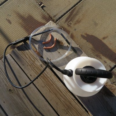

I use my homemade transfer pump made from a 1 gallon weed sprayer pump for filling the transmission,it also works good for filling rear diffs etc.
They're cheap and easy to make,and come in handy.
