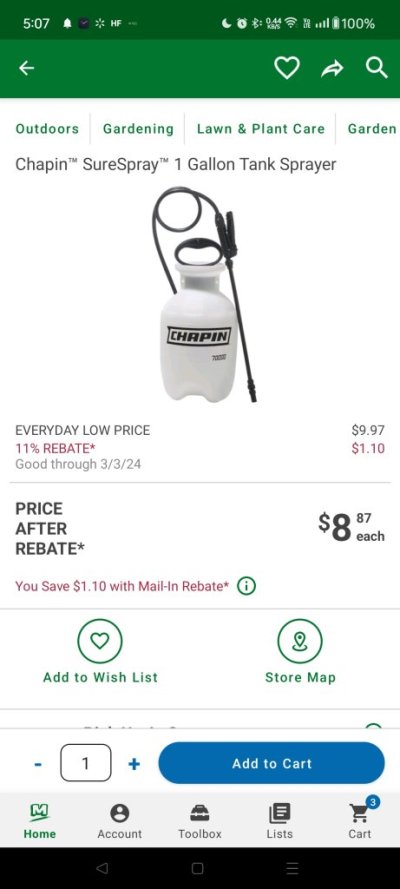

Keep an eye on Crappy Tires sales,they'll put the weed sprayer on sale ,usually starting in the spring. I think i bought mine for under 15 bucks on sale,but that was several years ago,but i'd hazard a guess it won't be much more then 20 bucks on sale even now.
I wish we had the Canadian tire here in the states. I want to build that sprayer. Why the copper 90's?
For those with a Menards you can get the sprayer for $9.
They're for filling other things.I have diff braces on the wifes Challenger and to get around the rear brace to the fill plug on the rear diff,the copper tubes make it easier
The prices aren't fabulous at Canadian Tire (CTC) but their weekly sale often has great deals.

I use my homemade transfer pump made from a 1 gallon weed sprayer pump for filling the transmission,it also works good for filling rear diffs etc.
They're cheap and easy to make,and come in handy.
+1 on the sprayer. That's how I've done my last several "filled for life" BS transmission services. That same sprayer fits the wife's Avalon and Honda. I cussed and cussed on the first FFL service I did until I asked "Isn't there a better damn way to do this than trying to squeeze a bottle at some ****-eyed angle losing half of the $hit on the floor???" Yeah..been there, done that.
