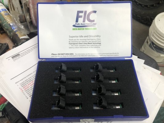

I got real lucky. I had notice a faint smell of fuel the day before I was to install the injectors. After they were installed, I jumped out the fuel pump to see what was causing the smell (loose connection or bad line). I put my hand behind the blower and could feel a mist. I had to pull the blower off to get to the rear supply lines to the fuel rails. Turns out the driver’s side fuel rail 180* connector had been rubbing against the SS fuel line and rubbed a hole. I'm lucky I found it before a major fire erupted.

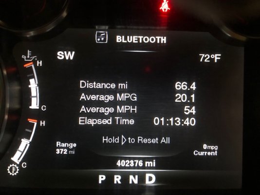

Well I didn't expect this! My commute is combined highway & city (Atlanta) mileage and I'm getting 20 +/- MPG. I took it easy to see her average best could be. Not bad for a SC Demon with an estimated 600+ WHP. 2014 Ram 1500 RC SWB Sport 4x4 with 37'' tires & 3.21 gears.

If you drive them decent a Hellcat Challenger/Charger will pull down better milege then a 6.4,and quite often a 5.7 in the cars.It's not uncommon to see guys posting of high 20's/low 30's out of their hellcats on a trip
Made a believer out of me!

What I'm most impressed by, is the 402xxx mileage.
Congratulations on getting those number Of miles

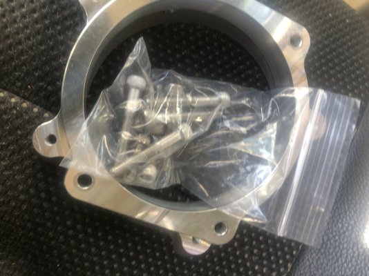

Bit of an update. The throttle body sensor has been throwing a code so I have ordered a new upgrade replacement. I’ve been chilling out with my mods until I get the rest of the drivetrain beefed up. However when a part needs replacing, it just makes sense to upgrade. I have a Demon 170 throttle body ordered which is a 105mm opening. It comes with an adapter to bolt to the Whipples 103mm intake connection. I’ll port match the Whipple if needed. They have had success on the 2.9 front T.B. Connection, hopefully mine with the rear TB connection will hook up with no clearance issues. I’ll keep you posted when it arrives.

This is going to let the 2.9 Whipple breathe!

That looks like a Hellcat TB,but bigger. I don't remember my Hellcat TB looking that big,lol
It’s the Demon 170 TB. 105mm which will allow the SC to be wide open. The Whipple CAI is sized for the 105mm size so I’ll have to open up the connection tube from 3” to 4”.
It sure dwarfs the stock 80mm throttle body,lol
