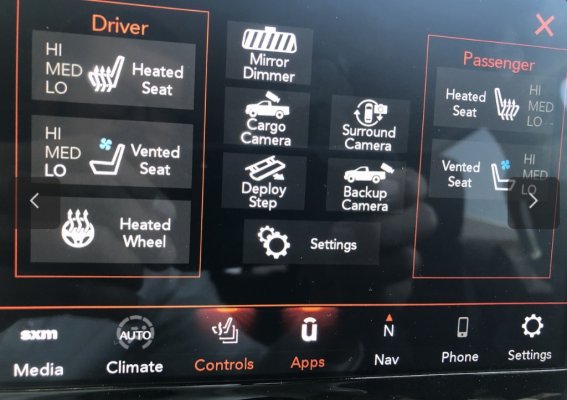

I used to be able to deploy my auto steps to clean them and now I cannot find it in the menu anywhere.
Am I missing something?

I thought I'd seen an option to deploy the steps too. Couldn't find anything in the manual so I went out to look. Under Settings - Safety and ??? there's a power step option, but the only choices are to automatically deploy it or keep it in.
Someone else posted that if you stood on the step with the door open then shut the door, the steps would stay out. I tried it and it worked. Good luck,

There is a control app, the one you use to turn on your heat or ac for your front seats. On that app in the center of the three columns there is a button to deploy your running boards. You can only do this when the truck is in Neutral or Park.

U Apps, then go to controls, and then it is in the top right corner to deploy/retract steps. At least on mine it is.
