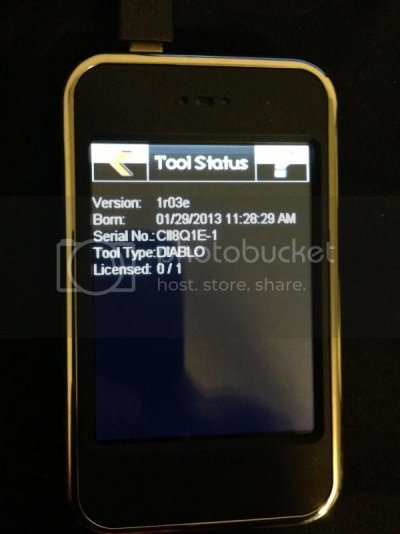

Just try to make sure it is "unmarried". If possible, have the seller send you a pic with it showing the screen. .....

You need to see this screen under the "tool info" section.
Licensed 0/1 means unmarried and it's good to go.
Licensed 1/1 means married and the seller is trying to hose you :)
