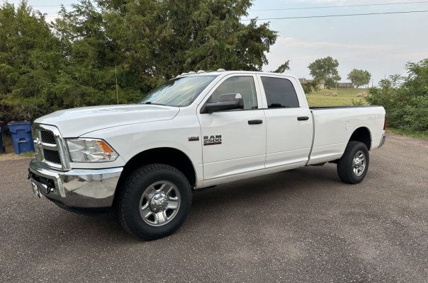

Just picked up a 2018 2500 tradesman last week. And the longer I look at it, the more squirrely stuff I see. It was used as a work truck I’m sure. But it has lower mileage and drives really well. But while looking under it today, I noticed that all of the cab mount bolts have been removed and reinstalled. I have the carfax for this truck and it’s incredibly extensive, except replacing body mount bolts or something related. Overall it’s in good condition with the exception of some body repair done at some point and usual wear. The body bolts bug me because I don’t know what’s been done. Looking for input here. Thanks!IMG_7894.jpeg

Newer vehicles should have body panel #s so check if they all match. Disclaimer.... I've never done this but a friend in the autobody biz tells me to do when looking at a used vehicle. But, I just call him and buy him beers to look things over so have never done it myself.

Chances are the body had to be lifted to get to something for a repair. What that repair would be, would be anyone's guess without knowing the repair history. That or it was involved in a rollover or other serious accident and they just replaced the cab, but that would likely be on the Carfax.

What I can actually see is the front passenger side of the bed has been repaired/repainted and it’s not perfect but definitely passable. To me it’s an obvious repair that I saw when I was looking it over and it doesn’t bother me one bit.

I've removed the cab bolts and reinstalled them myself while putting a body lift on. Throw a wrench on them to make sure they're tight and forget about them.
If it drives straight, everything works as it should, crawl up under it and check for tight, as mentioned above. If all good, roll on. You'll drive yourself insane obsessing over it otherwise. Ask me how I know. I'm not arguing with me, yes you aren't. Get off my keyboard. Stop it. You stop. :)

There was a nuisance issue of clunking sound under the cab, and replacing cab mounts was "a fix" prescribed. I wouldn't sweat it unless you discover something beyond that.

It could be pervious owner used Nerf bars that used the cab bolts, I know the one I installed on my 2006 came with new longer cab bolts for the nerf bar brackets...

Could also be one of the many where the cab and box didn't line up from the factory and needed adjustment.

I'd forgotten about this, I think it was common in the early/mid '00s to need to pull the cab bolts to install a LOT of aftermarket nerf bars. I put them on my FIL's '03 and you're 100% right, had to pull cab bolts to install them.

Could have been taking them out to lift the cab to get to any number of small simple fixes. Unless you actually see something wrong, don't worry about it.
I was thinking the same thing. Dave's Auto always lifts the cab on these HD trucks as they can clean everything and also it gives access to the entire engine bay. The question is what dis they fix? If you have the Cummins and have not replaced the engine heating grate bolt, do it quickly. If it let's go, it grenades the engine.

Is it possible they removed the cab bolts to pull the frame back into alignment?
