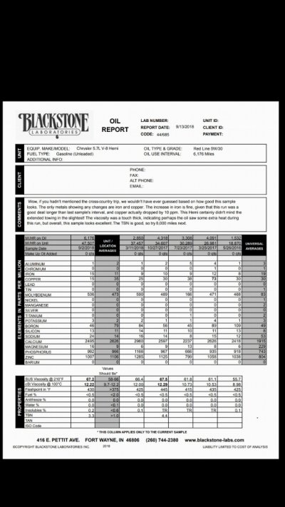

Heres a UOA I did couple years ago. It was my cross country trip towing my camper from MA to UT and back. Went each way thru the Ike Gauntlet too. Even Blackstone was impressed.ac6ce6518904442adcb27394b0dc7d44.jpg

Thanks burla. The Red Line looks like it works well in these motors. How about Amsoil Signature 5w20?
