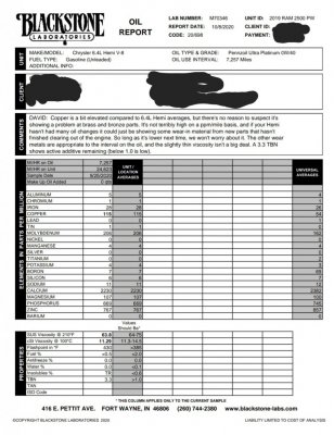

Just changed out the Pennzoil Ultra Platinum 0/40 and replaced with Redline 5/40 and Royal Purple stock replacement filter. I will say the motor never really had a "tick" other than the standard valvetrain noise that tends to accompany the 6.4, but it sure is running quieter with the Redline.
I sent the Pennzoil off to Blackstone for a UOA and a TBN for ***** and gigs. Just over 7,200 miles on the oil change interval.
Will post up the analyses when they arrive.
As promised, just received my UOA from Blackstone:
Looks like we'll be tracking PPM levels as some were a bit off. Viscosity was also a surprise.
Will continue to perform UOAs from here on out to keep an eye on things.
Interested in hearing any feedback from the oil gurus here.

This is a redline thread, next time you can use other oil thread or blackstone. No big deal though.
So yes, 0w40 PUP is known for shear, but that viscosity is fine for the 6.4. Since this is fca's oil, it is also why I have kyle trying 5w30 redline, because it will be thicker then your 0w40 at the end of the interval for sure.
I know this wear looks troubling, but I wouldn't worry as the miles are so low, you are still in break in period. You can tell because you are getting wear in several areas even aluminum, this is just new engine wear. The oil looks fantastic, and your interval is perfect. With this much wear, a little over 3 tbn is perfect, I wouldn't change a thing. Do the same exact thing with the same exact oil with the same exact miles, my guess is next uoa wear will have dropped like a rock buddy.
Let me ask you, did/do you have any hemi tick, even dry starts?
