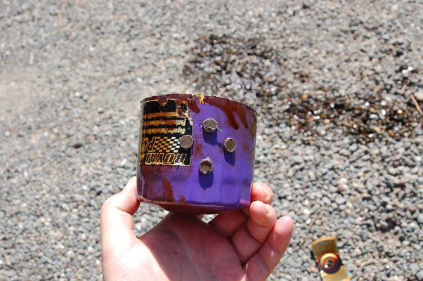

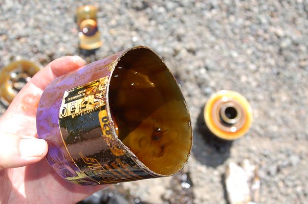

This is about as impressed as I have been, ran heavy gauss magnets and all you can see it an outline on the filter wall, ran the oil a long time a year and a half I believe and it was black. Mind you this was a previous hemi tick engine, and after a year and a half this is all the metal I get from magnets? I could have never imagined it would have been this good, first time running mags, and I think I'll transfer them over to trans because they are not needed at all. If you zoom it you can really barely see the outline of the 4 mags. Love it!
redline 5w30
