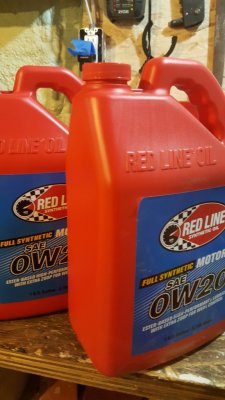

1gallon 0w20 2qts 5w20 rl ...truck in quiet cold and hot...i had a faint tappin when truck idled down when cold..and a faint tappin when hot ..but always quiet mid temps ??? with redline its quiet no tappin at cold or hot...just changed oil sat..im on 0w20 only now..
