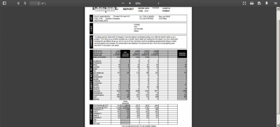

Posted in the syn thread also. Reserving my vote after more redline.
Went from FF to PUP until this last change.This report was RL 0w40 as was all the PUP. Both PUP and RL develop Hot tick after 3K miles. I cut open the last three RP 1048 filters don't see anything visible of magnetic. Still concerns me bolts seem ok. does seem like viscoty is better. I had to do an OC last weeK after this oci, and used the last PUP I had on hand.
Maybe go back to RL . Still under the Power train warranty only.

Greg thanks for updating us, we want everyone who has tried it to vote, so please vote unless you are waiting to see the tick subsides. I encourage you to look at bolts again, but if your hemi is still warm idle ticking please vote as well, gives the forum accurate info.
side note every uoa of redline is heavy the first time, it could be to leaching ions or increased wear from anti wear additives. Anti wear additives create more wear at first, then lower, it is a fact, that is why we have zinc break in oils.
