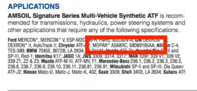

Im wondering what you guys think of this listing on the Amsoil site. They appear to have a fluid listed for the BW 44-44 T-Case now.
AMSOIL Shop by Product

Update: I called Amsoil this morning and they pointed me to the data sheet and confirmed its use for the BW 44-44 T-Case. The data sheet has the Mopar part number listed in the specifications as approved for use.
Hope this helps the next guy in the search for answers.
Just to be clear, it is "approved" by AMSOIL and not FCA. Have a transfer case issue under warranty and if claim against the fluid is made as cause, FCA is going to wash their hands of it and you will have to deal with AMSOIL for claim of failure and restitution.
I am sure the AMSOIL will work fine but it is not an approved replacement by FCA.
