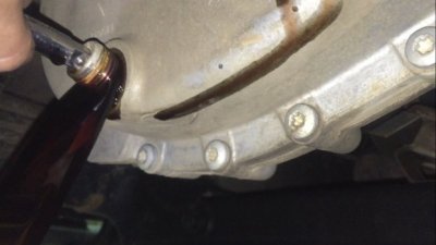

I did the F/R diff and transfer case. I have the BW 44-44, and looking back at all my service papers I have never had the T-case fluid changed, only the F/R diff. So what is in the T-case was original, it was also red like big_red06 stated. Here is a pic of what came out.
I used all Amsoil products that they have listed for the 2011 ram, they mentioned that I should not need the limited slip additive. I purschased it anyway in case it chattered at all after the fluid change. I took it out for a drive and it's quiet and smooth, I will hold on to the additive incase I need it later.
So far so good! I wanted to post my experience so the next guy who goes looking for info like this has something to reverence.
T-case is Signature series multi vehicle ATF - ATFQT
