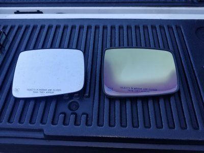

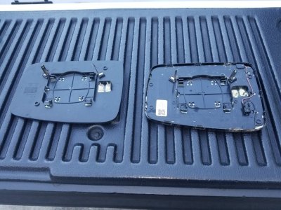

Alright fellas, I don't remember if it has been covered in this thread but I just replaced my auto dimming glass portion on my upgraded p/f mirrors and I the regular power/heated glass from the non p/f mirrors has mounts the same, fits and holds perfectly.
This could be why people had reported their passenger side p/f mirror is not auto dimming.
I also been wanting to color match them mirrors so I wrapped the same mirror since I was already in there. Took it apart still mounted like @Mpgrimm2 when he was going from chrome to black inserts.
Now the question is how long will the vinyl hold lol.
Pictures for reference

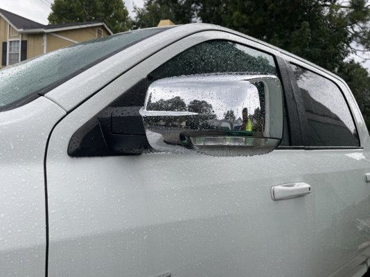

Just finished installing my power folding Crome mirrors and lighted switch Waiting on new modules to complete image.jpgimage.jpg

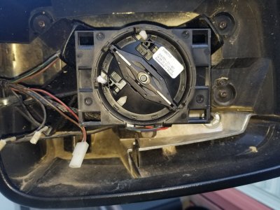

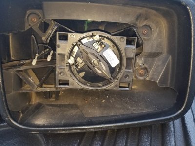

I bought a set of Laramie mirrors a while back and just got around to seeing if they worked. The driver side mirror folds in and out just fine but does not adjust. I can hear the motor whirring when I press the button but the actual part that holds the mirror does not move. Would I be able to swap that part of the assembly out with another mirror? Or would it have to be specifically another Laramie piece? Here are 2 pictures of the part in question. I have a set of express mirrors and a set of big horn mirrors. So if I could swap out the mirror mount/gyroscope piece that would be pretty great lol
