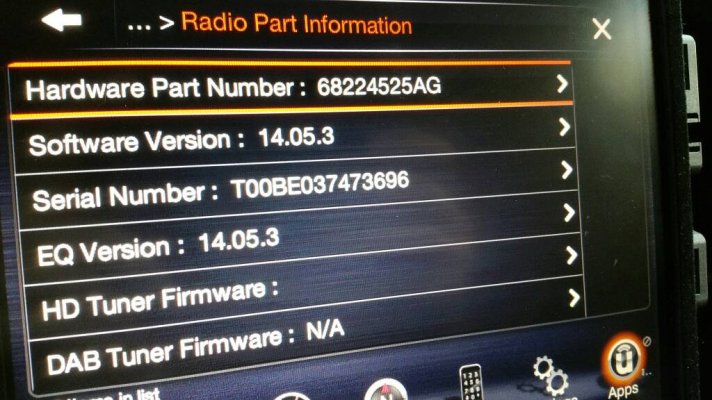

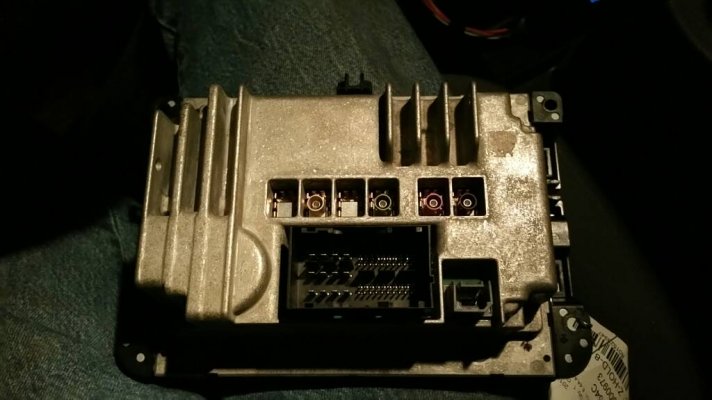

Got a question here. Bought this radio from a salvage yard. Has no serial number sticker on it. How do I go about getting unlock code? Or am I better off sending it back and getting another?
I'd send it back...

I'm not sure I would keep that one. If they have another one I would send that one back. Gotta ask yourself why someone would take that off.
That's what I'm thinking. How would the salvager even know what to send you without the part number? I'm sure they know lots of parts, but this part is identical to other models with different part numbers.

I didn't know you could get it from there. Thanks...
You're firmware/software number looks fishy though. I would recommend not attempting a firmware upgrade.
Anyone else see this firmware version before (14.05.03)?

Good news. I found the serial number. I got the code. I had to use engineering mode to get into the radio to find the serial number
Fyi quick google search of the firmware is coming up with an update from 2/27/2014. But for a Canadian version. I guess that could be an issue without proper information that used to be in the back of the radio.
That is nearly the same radio part number Jared 4.7 has and he updated to the latest fw. But who knows.
2014 Ram 8.4AN
68224525AB
14.25.5>15.26.1
Zero problems since original install and recent update.
Thanks for posting pictures of that engineering screen with the part number.

Had to hit climate so that the pass code screen would go away. Then enter dealer mode. Temp up/down/front defrost buttons same time. Glad I got the OEM bezel.

FYI. If anyone needs a reference for the various RA4 modes, I have it linked in my FW Info thread
