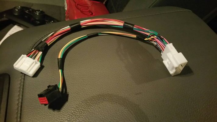

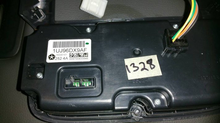

OK guys n gals. Got some questions here. Got the 7 speed harness from cuylertech.
I see the square harness plugs into the control panel. I figure the male n female white ends are a T harness of sorts for the HVAC controls. What is the small rectangle plug to? Does the wire that clips into that come with the HVAC control module I gotta buy(not the dash bezel, the little brain box)

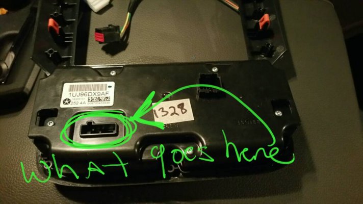

You will need the HVAC module to plug the other end of the white T to. There is no plug that goes into the second plug on the back of the bezel, thats just there for manufacturing.
Hvac module is ordered. Part number 68183973AB, correct?
So the circled plug isn't used?

Yes, that is the correct part number.

So, the way this works is one end plugs into the truck side plug, the next to the HVAC module and the last to the bezel. They only plug in one way so once you are looking at it, you'll get it.
