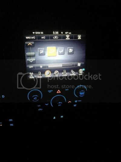

finnally got it all buttoned up today the new harness arrived thanks again Cuylertech works as it should and was very well made and its all working as it should here it is IMG_0411.jpg

Congrats. Looks good.
Hopefully I can join the club soon also.

Wow ! Looks Great !

now its going to take me a little while to figure out what half of this stuff does like a new truck all over again its awesome all thats left now is to save up for the premium cluster and the interior will be done

Lol Done ? Never done , not when your a member here !

took me several months saving ,reading this thread about ten times and asking a bunch of questions before i even felt comfortable enough to try this glad i did it was alot easier than i thought
