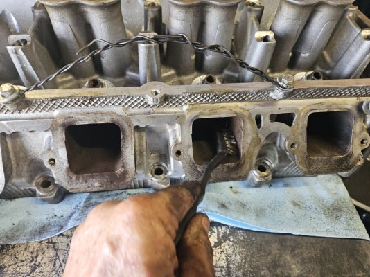

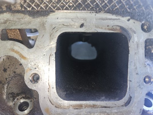

Started cleaning up my heads and valves. Damn, is there an a$$load of carbon in the ports. Knocked a bunch out, then hit with some wire brushes.
I had already gotten a bunch out before this bunch in the intake ports.
Jan 17, 2016
23,819
54,830
14 Sport
I had already goten a bunch out before this bunch in the intake ports.
Damn she'll run like a new truck by the time you're done Ed,lol.That is a fair bit of crud in the intake ports though,are you running a catch can?
No, not yet.
That's 200k miles, with nothing done to the truck.

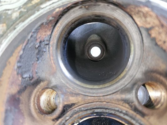

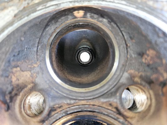

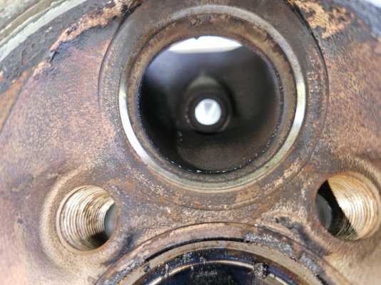

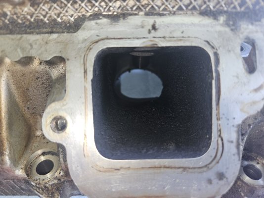

After wire brushing hell outta the ports, then soaking and scrubbing in in LA's Totally Awesome Cleaner and water 1:1
Intake ports 7, 5, 3, and 1
Exhaust ports 7, 5, 3, and 1
Still more cleaning to do, then on to passenger side cylinder head.
Intake ports 7, 5, 3, and 1 View attachment 570828
View attachment 570824View attachment 570825View attachment 570826View attachment 570827
View attachment 570828View attachment 570829View attachment 570830View attachment 570831
Got any finger prints left on the tips of your fingers Ed :Big Laugh: Damn you're doing a good job with cleaning them though:waytogo:

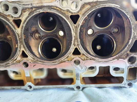

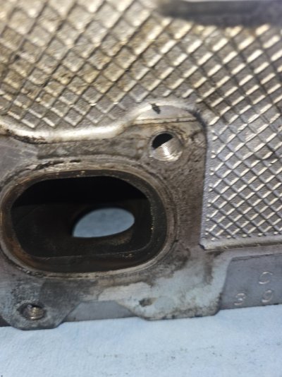

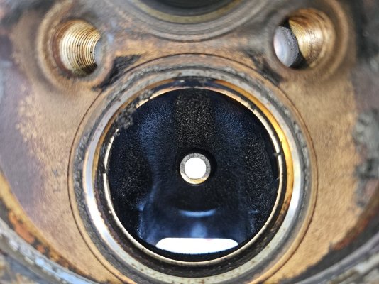

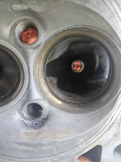

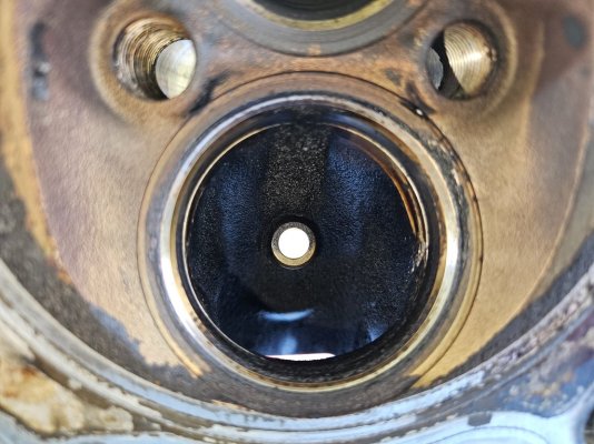

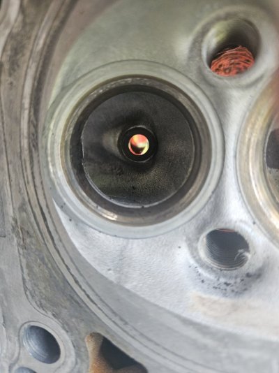

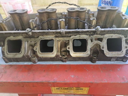

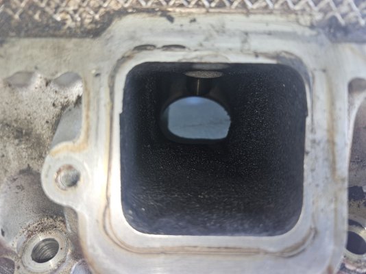

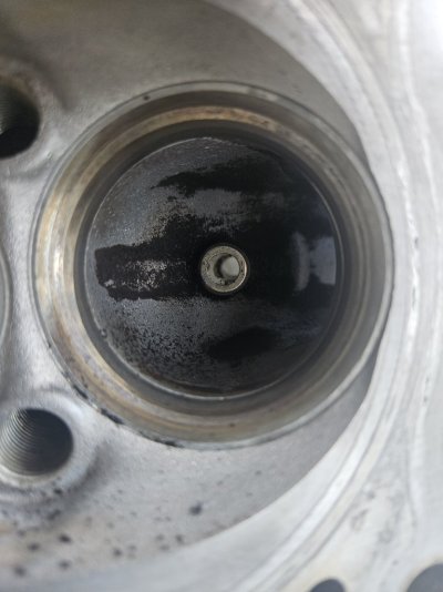

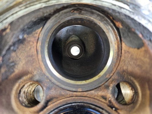

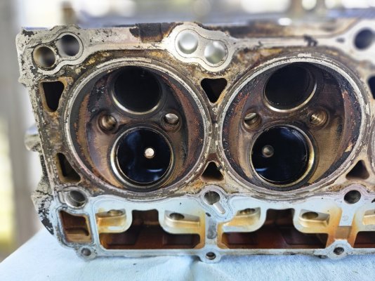

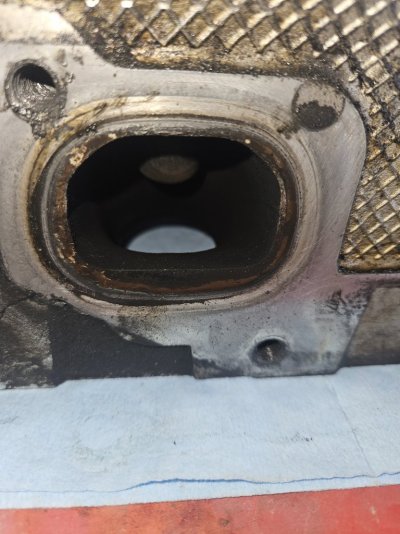

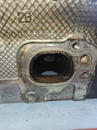

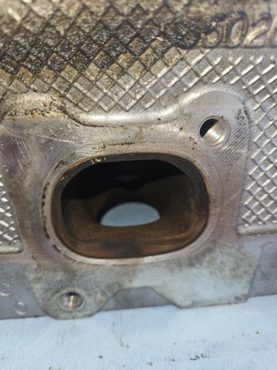

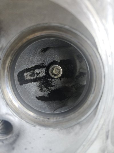

Here's the passenger side head, untouched.
Intake 8, 6, 4, and 2
Exhaust 8, 6, 4, and 2
Exhaust 8, 6, 4, and 2, valve side
Chamber 8, 6
Chamber 4, 2
Barely.....lol.
That cleaner leaves my fingers like prunes, and slick, too.
It looked like it might leave a little residue, but hard to tell because the water here is very hard.
I stuck both heads in a tub of water and Dawn dishsoap, think I might let them soak for 24 hours to see how that behaves.

Actually those aren't bad for 200K,i've seen chambers and ports in far worse shape then yours with only 80,000 miles on the engine.That's a testament to using good fuel and staying on top of your oil changes
That's wild, because I run 87 almost exclusively, and was changing oil by the OCI up til now, so I guess I was extremely lucky.
Also, less than 9% idle time.
Gonna run RedLine for my first full change, and better gas as well. As well as shorter intervals for oil changes from here out.

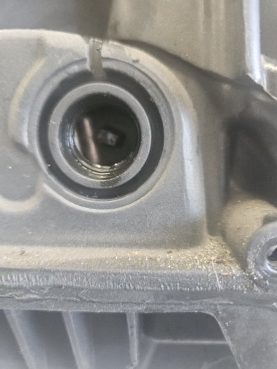

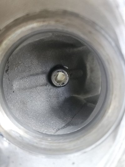

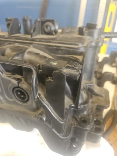

Ok, since I had some time, I removed the throttle body, fuel rails, SRV, and pcv valve.
There is some internal stuff to the SRV. Anything I need to worry about while cleaning?
Also a sensor, related to the srv? Does it come out? Didn't want to break something.
TIA
