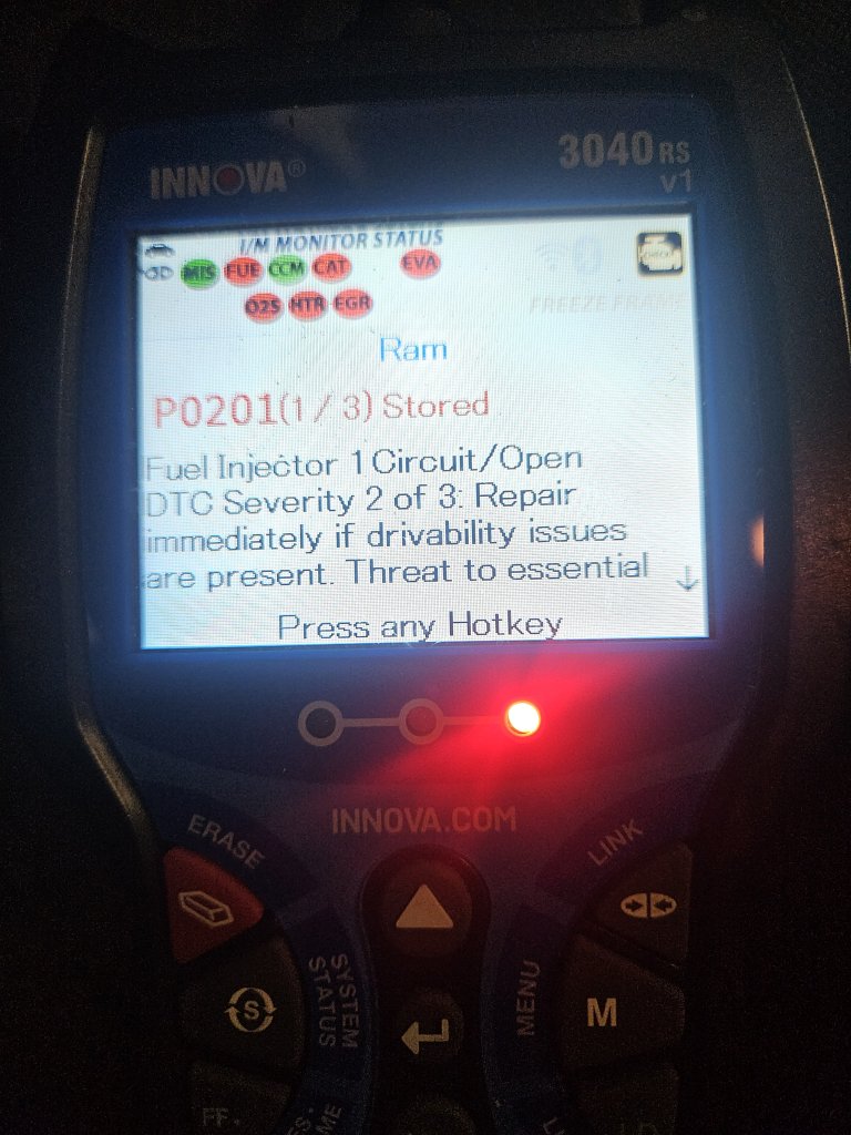

... well, I'm curious ... that if you've found the culprit on what was causing the PO-201 code ...?
EdGs
EdGs
Nov 29, 2020
5,562
11,804
FL
I haven't had a chance to check it out further. Gonna be back at it tomorrow morning, hopefully.
Does anyone know how the injectors are wired into the harness?
Since the 12v from the ASD relay is common to all, is it supplied by one wire, and each injector taps into that? Or do the brown wires on each injector go to a common point?
Sorry for the questions, I haven't had time to look in the electrical section of the FSM yet.
First, pull the injector and test it. I hear a 9v battery will work nicely.
Yea, they tie into a common point For the power supplied to the injectors. Same colored wire on each injector. The "where" that this common tie-in occurs, is buried somewhere under a wire loom and would be tough to find.
The PCM controls the injectors on the ground side, so each injector has its own control wire to the PCM. The different colored wires will be the control wires.
Since you've already stated that you had to stretch the wiring harness to make the connections, I'd start with the pins and wiring at the connectors.
Use your scan tool to turn on the suspect injector. If it doesn't turn on, wiggle the harness around while activating the injector. See what/were the bad connection is. If it DOES turn on, keep wiggling the harness with the injector activated until you find the spot where wiggling kills the injector.
If the injector tests good, and the wiggle test doesn't show results, put a test light (icepick style circuit tester) alligator clip on battery+, probe the control side pin of the harness connector, and turn the injector on with the scan tool. When the PCM activates the injector, it should close a path to ground on the control side pin of the injector connector.

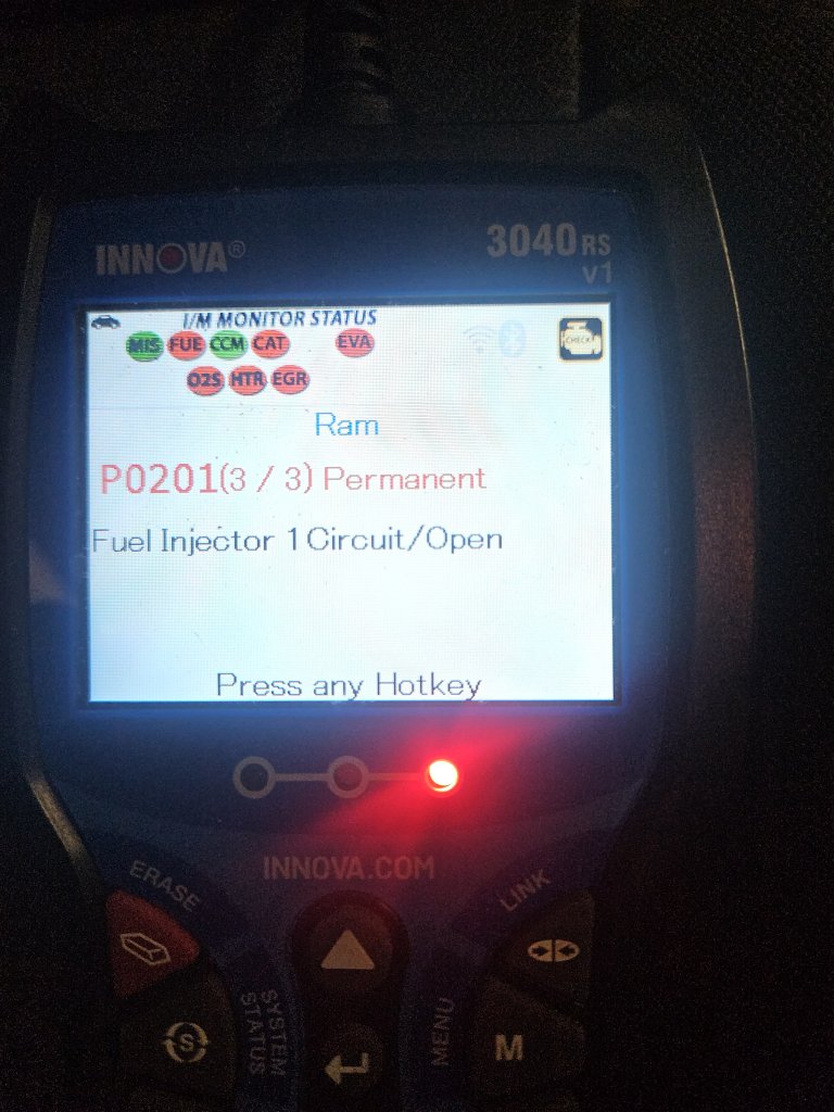

Thank you @Ken226, not sure what I can do with my reader, I wil have to look that up. Just have an Innova that I got when I threw a check engine light on the way back fron NC (my fuel level sensor decided not to be a team player).
It was odd that I had no slack in the harness there, Nothing is pinched anywhere I can find, maybe I got things twisted about (I don't see how).
I printed off the pages in the FSM for checking that code, I believe it's gonna be a wire. I made up a pin and short wire that I can insert into the PCM connector and check the output wire to the injector plug (I hope). If I can read the +12 at tge injector connector, I can at least see what is missing, provided the injector coil is not somehow open circuit (highly doubt this, but anything is possible, Ed luck in play....lol)
Just hope its simple to find and fix.

I really don't understand how that harness came up short.
On that side, it comes from the battery/tipm and runs toward the firewall then clipped along the valve cover routing toward the front, then I think around to the A/C compressor, knock sensor, and starter.
EdGs
EdGs
Nov 29, 2020
5,562
11,804
FL
Ok guys, I might have screwed the pooch.
I AM SOFA KING STUPID
That harness that was "short" for the alternator
Might have been the injector plug reversed with it.
That being said, I'm hoping that it it didnt plug on fully or else I believe I would have worse problems.
The color codes of the wires do not match with what I have from the FSM
And the plugs fit with no stretch on the alternator.
Hope I didn't f*ck up the PCM
Gonna check my wire paths.
