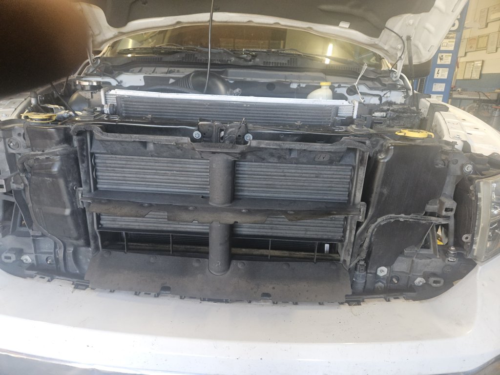

Rad should sit straight up and down,so you might want to look it over close and make sure the bottom is in place.
It's definitely a body bolt of some sort as it's not an engine or exhaust manifold bolt.Are you sure you have all the airbox bolts back in place,as it sure looks like it could be one of them.
Radiator went right in and is sitting in the mounts. It's not tipped much, unless theres some rubbers that go on the top where it bolts in.
Its maybe 1 inch tipped forward. I noticed it while hooking up the lower rad hose.
It was more noticeable without the shroud and E-fan, and from the top, it looks straight up and down.
Yeah, had 4 bolts for the airbox, 2 inside the fender and 2 under the curve of the wheel opening.
The shroud and e-fan also went in with no issue as well.

Also noticed the radiator sits tipped a bit forward, I never realized it before.
Ya know, that might be an optical illusion, just remembered the engine is tipped down in the rear. So, it might be that's what makes it looks tipped.
Combine that with my lazy eye, and............lol
That's what they make levels for........ LoL

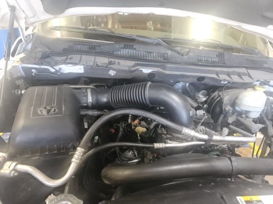

Ok guys, she started up!
However, I had a service shifter message and a check engine light.
Misfire P0301, sh*t.
It did not seem to be running bad, so I reset the codes and started it again.
This time, P0201 injector circuit open x3
Giving a little gas, I can feel it but silghtly.
Reset codes, and tried once more, same same.
Not sure what to do next. :(

Go back over the electrical connections especially the injectors,i'd pull the connectors and make sure you don't have a bent pin,which could of happened when you were cleaning the injectors.
I did pull that connector apart and the injector pins looked straight.
I had one hell of a time with the harness in that area getting enough slack to hook up the plug on the back of the alternator.
I will take a look after work tonight.

I gotta do some checking, had a P0301, now P201.
Had trouble getting enough slack in the harness to plug in the alternator, I'm not sure why.
Hope its just a bad injector, but they worked when I cleaned them. Hope it's an easy find at any rate.
Not sure where my test light went, hello Amazon.

They never just start up and run 100% from the days I spent at a buddies machine shop. He just did the boring but the shop next door did most of the installs. The scary part of over is started and ran, sweet. test injector circuit with multi meter if you cant find the bad spot
