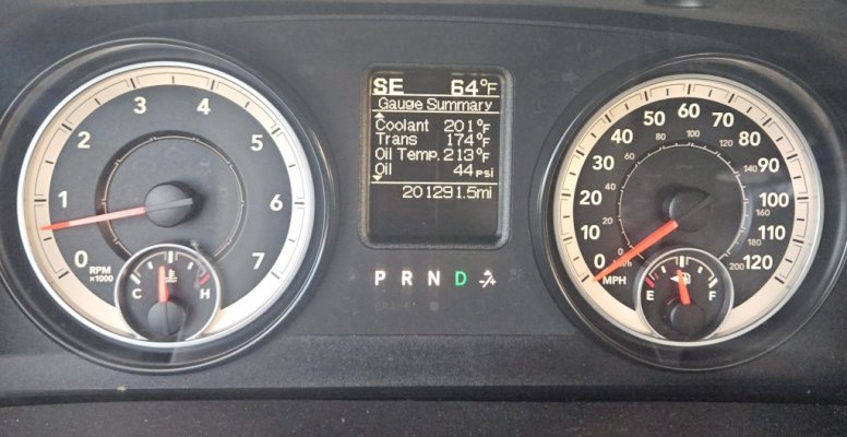

Truck ran good today.
Here were my numbers sitting at a light on the way home, about 100 miles since the repair:
I just have the coolant lines to the transmission heat exchanger disconnected and installed a Motorad 192° thermostat. I have not installed @caulk04's bypass yet.

Ok, one thing I noticed driving home today:
At full hot, stopped for a light, my idle would drop to a little over the 500 rpm mark on the dial, and my oil pressure would drop as well to 40 psi on the evic.
Idle still smooth.
If I shift to neutral, my rpm would increase to ~600, and my psi would increase a few psi. I have a hellcat oil pump with the relief spring from my stock oil pump.
This is not new, before my cam job, with the stock oil pump, my pressure would drop, sometimes to ~34 psi, and also increase rpm and psi a little when shifting to neutral.
Only seems to happen when fully hot, not every time, AFAIK. Oil is thinner with higher temp, lower psi makes sense.
Idle still smooth.
Only seems to happen when fully hot, not every time, AFAIK. Oil is hotter, and thinner with higher temp, lower psi makes sense.
I also realized I did not clean the map sensor or the sensor on the inlet pipe to the throttle body.
Thoughts on this?
Mine idles at about 500-550rpm and about 32psi when at operating temp. If I shift into neutral, it goes up to about 600 as well. So, that all sounds pretty normal.
Except that obviously, your oil pressure is higher at idle.

If they've never been cleaned it's worth giving them a tidy job. Use the proper cleaner on both,the sensor in the intake duct is the IAT /intake air temp sensor

When I got my truck, it did the same thing about 1.5 seconds after a full stop in drive, 500 -525 RPM and 36-38 psi. After putting on the tune and adjusting to 700 - 725 RPM idle. it steps down to 675-700 after a second now with a little over 40 psi hot. At highway speed and hot, oil pressure is normally 58-59 psi.
Engine internals (cam, lifters, oil pump and such) are all original as far as I know. Just a 91 octane tune w/ some minor changes, low restriction exhaust and a CAI.
