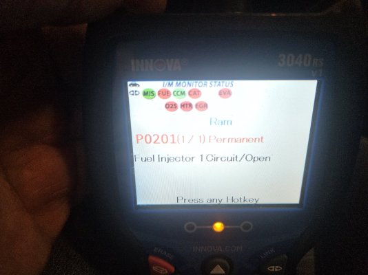

When I hook up my code reader, I get a permanent code for the P0201. If I reset it, the code is still there.
Does it take some drive cycles to erase It?
It might go out with a few drive cycles,if the trucks not misfiring,i wouldn't worry to much about it Ed.
Glad it was an easy fix and she's up and running for you now.
No, not misfiring. Actually running smooth I think.
Yea, permanent codes can't be cleared with a scan tool. After several drive cycles without recurring, it will clear itself.
Thank you, Ken

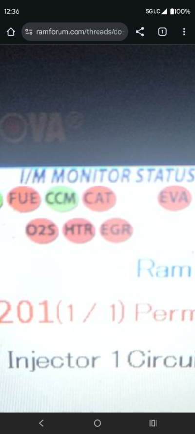

Thank you, Ken
Went for a drive yet?
After a decent length drive cycle or two, those readiness monitors will turn from red to green as each test is completed successfully.
Until then, there is still a small possibility that some pinched wire or damaged sensor will rear it's ugly head when the PCM attempts those monitor tests.
No, still putting the shrouds, grille, and wheels on. Maybe in about 30 minutes, I will.
I'm relatively confident that nothing is pinched, I had the harness tied back to the wiper arm, until the heads were on and torqued, before I reinstalled the intake manifold.
Fingers crossed
Just hope my plug dyslexia didn't F U B A R something.

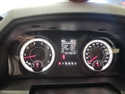

I ran it about 10 minutes, had a low tire, couldn't see anything in it, aired it up.
Only got to go about 35 on a couple streets by my house, will take it to church tomorrow, about 25 miles away.
I havent driven her in so long, she seems sluggish, but I know it's just me. No check engine light, good oil pressure too. Was gonna change this oil right away, but will run it tomorrow and maybe monday, that'll be 100 miles roughly.
Make sure you change oil/filter now that you've drove it around the block a few times,then i'd change it again in about 500 miles Ed. If it didn't set any codes driving it around the block,you're probably good now,
Cleaning all the carbon off the pistons and heads probably dropped the compression a bit,and she lost a bit of power,lol.Just kidding :waytogo: :Big Laugh:
After you get fresh oil into the ole gal,don't be scared to give it a good hard run ,to reset the adaptives.
Roller cams don't need no break-in,but they do need some good splash lubrication off the crank,and the only way that happens,is if you drive the hell outta it,pretend you're 16 again,driving the old mans truck:Big Laugh:
