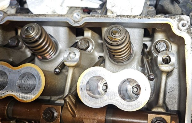

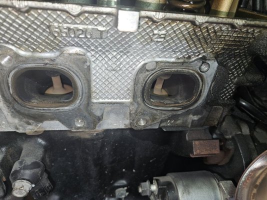

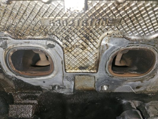

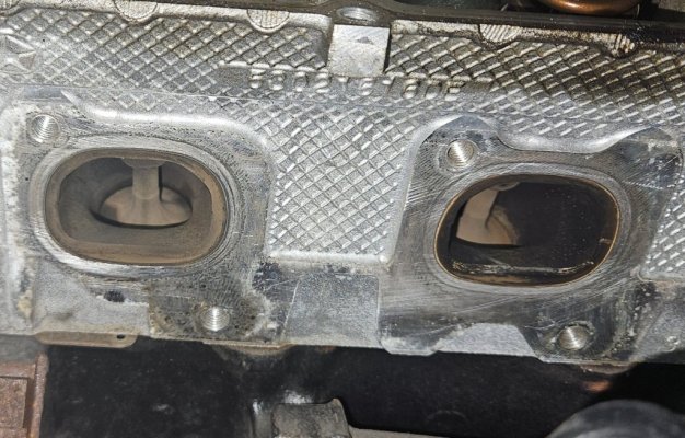

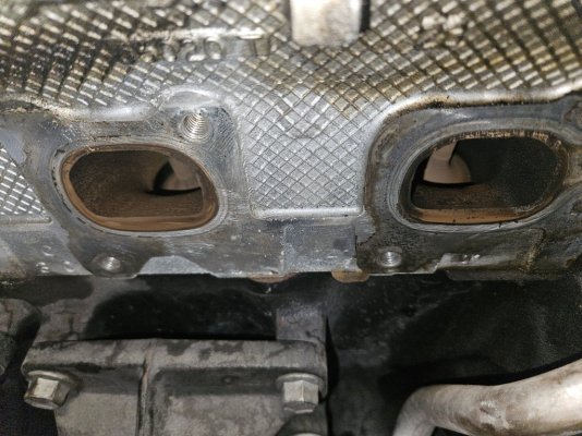

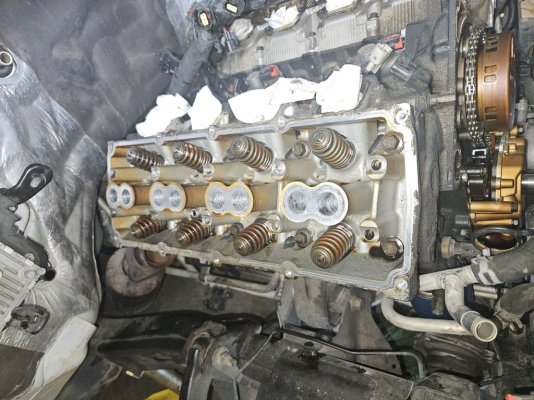

Pics of my exhaust ports, a little carbon on the inside of #1 exhaust valve. Other than that, they look ok to me.
Cylinder 1 and 3
Cylinder 5 and 7
Cylinder 6 and 8

They look good but at least one is a little wet, toss some new injectors in this, which I'm betting you already doing.
Yeah, planning on cleaning all the injectors individually, along with intake, throttle body, and the heads once I have them off.
And since I'm gonna be replacing the valve springs, I'll be able to clean any crud on the valves and seats if need be.

Tip the heads on their sides and pour some laquar thinner or acetone in each port to check the valve seats ,if any leaks through,the seats will need some touch up hand lapping

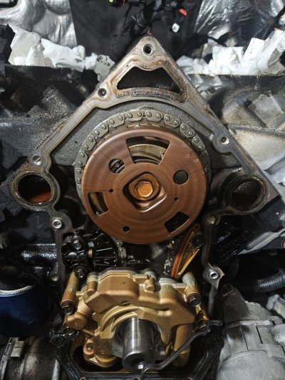

Harmonic Balancer pulled, timing cover off.
Oil pan bolts out, but pan is stuck like chuck
At least gasket to pan is. Gotta quit here, go home and smoke some baby back ribs.

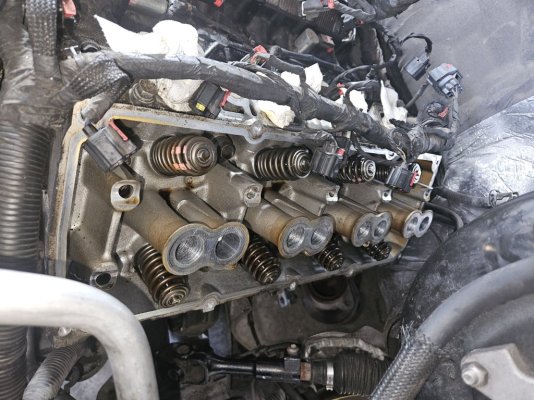

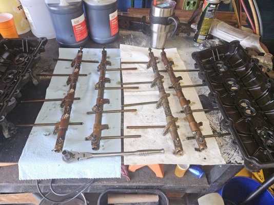

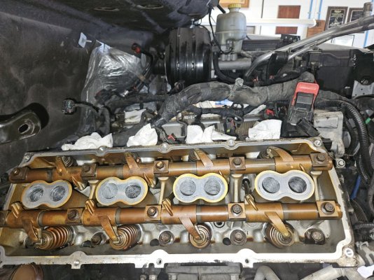

More progress.
Rocker arms and pushrods out,
Pushrod locations, 1, 3, 5, 7
Exhaust: Left side of intake valve spring
Intake: Right side of intake valve spring
Pushrod locations, 2, 4, 6, 8

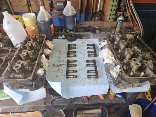

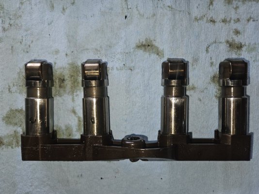

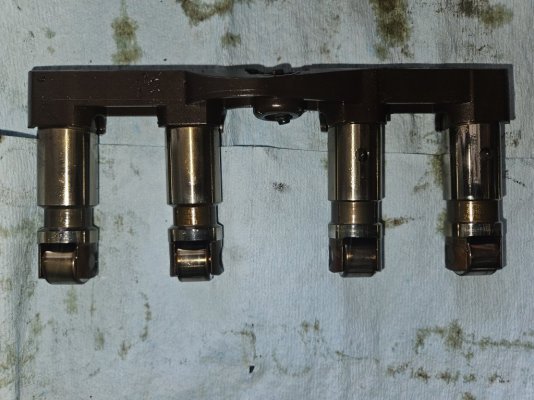

......Heads are pulled, lifters are out:
Cylinder 2 and 4: No issues, slight side to side play on roller, shiny roller surface.
Cylinder 6 and 8: No issues, slight side to side play on roller, shiny roller surface:
Cylinder 1 and 3: No issues, slight side to side play on roller, shiny roller surface:
Cylinder 5 and 7:
HOUSTON, WE HAVE A PROBLEM!!!!!!
#5 intake roller shows scuffing and lots of play. Roller has not flattened yet, but I'd wager it wouldn't be long. #7 no issues, shiny roller:
Just realized my pics dont show the shine on the 2nd set of lifters., sorry. I will edit in better pics later.
Video to follow shortly, then on to checking the cam for damage.
So, so, so glad I heard the sound and stopped driving it.

Can't see all the pushrod ends,but while they're out,look the ends of them over close for wear/chipping etc. Ed,also look through them to make sure they're clean and straight.Good job on taking your time,that helps mininiumize alot of issues.
Pushrod ends look nice and shiny, but will give them a closer look.
