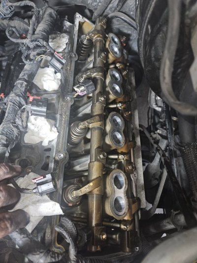

Driver side valve cover pulled.
As far as I can tell, none of the pushrods are loose, the ones I can get my fingers on I can spin them. No play on the rockers between the pushrods and valve springs.
What is this connector bolted to the rear of the driver side head? Ground?
Yup,and don't forget to reconnect it,like alot of guys do,if it's in rough shape,i'd even consider replacing it,as it's kind of important.
