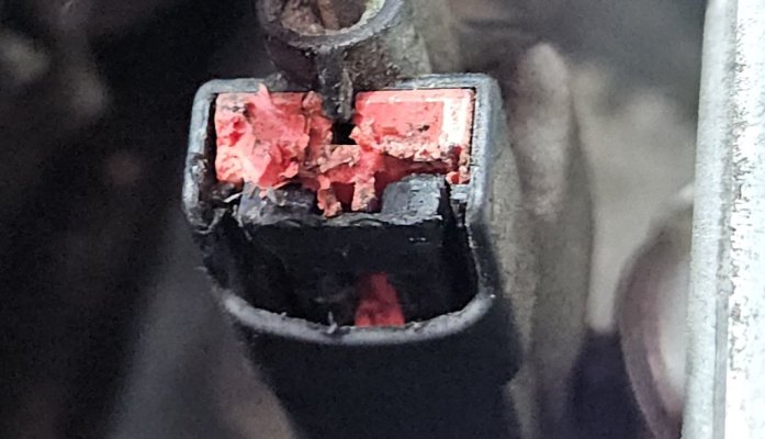

Well trying to get the intake off, broke the red lock clip for#6 injector.
Broke so I don't know if I can get tge important part out. Any ideas?
Tempted to cut that SOB off. Frustrating.
Guess I gotta get a sharp point in there. Don't have a pick. Gotta make one I guess.

Got it! Found a pick tool.

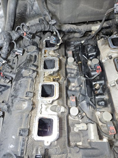

Post some pic's of the intake ports on both the manifold and heads for all the catch can non-believers Ed.
Pour some gas inthe manifold,and shake the hell out of it,then dispose of the used gas in an eviromently friendly manner ;) ,then spray a bunch of engine degreaser inside it,and run it over to your local carwash and use their high pressure soap setting to wash and rinse it out. A rag soaked in Acetone / Laquer Thinner/ Gas / Brake Clean etc. makes short work of wiping out the ports in the head.

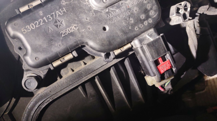

How do you unhook that connector?
I have alot less patience now that I'm older....lol
It's a pretty standard clip,you just have to push down on the locking tab,after pushing the red locking tab out,to the release position,sometimes it helps to push the connector on,as you push down on the tab under the red tab.
This is the red tab in the locked position,if you look close you can see the release tab under it,that you have to push down on.
If you can get at the 10mm bolts with a small 1/4" ratchet and socket,it might be easier to unbolt the srv actuator,and remove it from the manifold,then once you get the manifold out of the way,you can get at it easier.

Ok, got the intake off, WHAT A PAIN IN THE BALLS, had to undo the PCM plugs, the plug by the passenger side, and the ground on the passenger side fenderwell, and finally got enough room to move the intake enough to get at the SRV plug.
In process, I found 2 more wiring retainer clips at the back of the intake. I just could not see them.
I had some raw gas on to of the drivers side valley, and some oil on the passenger side valley as well, but think this is all from dicking around trying to pull the intake.
Ok, @Wild one, as you requested, this is for the Catch Can Deniers:
2015 Ram 1500 SLT QC 2wd, 201250 miles. Bone stock, the intake has never been off this engine, I've put 173,000 miles on it myself.
Drum roll please (btw, I vacuumed ALOT of crap off top of the heads and intake side of the valve covers before these pics).
Driver side:
Passenger side:
Stay tuned.

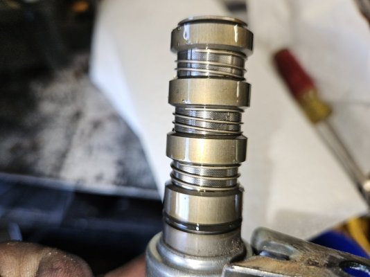

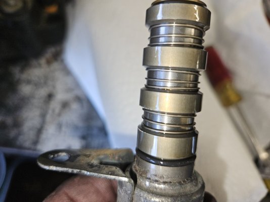

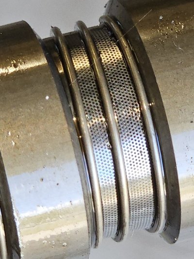

Oil control valve.
There are a few very small specks of metal (<20?) and some specks of dirt from my fingers.
Thoughts????

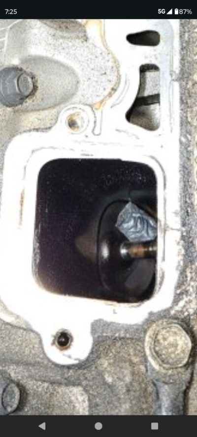

Hey Ed.
Reach into that port and get that piece of debris out so that it don't end up getting sucked into the cylinder. It might be nothing, but not sure. Better safe than sorry.
Vacuum deployed.
Looks like my heads are coming off anyway.
@Ken226, the vacuum got it, seemed like a piece of plastic bag. Thank you for spotting it.
