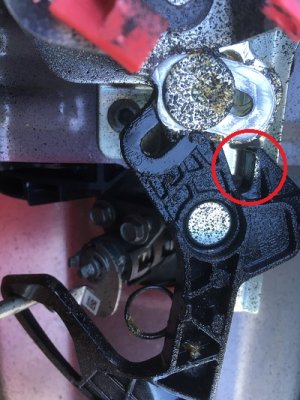

So, recently I found that my tailgate was not locking with power. In addition, it was not locking with the key and there was a lot of resistance when attempting to turn it.
I finally got around to opening up the inspection plate to see what was going on and found this...
If you're not familiar with the tailgate recall, our truck had an issue where the linkage that latches the tailgate closed had too much travel. This excess travel caused the tailgate to open on its own at random times.
When I originally brought this up to the dealership and pointed out that it was a known issue, they said my truck was not affected by this issue. It had already happened to me three times, one of which was a hair away from the hood of the car behind me when it fell.
I decided to fix it myself, the part to fix it is a small rubber spacer that limits the travel of the latching mechanism. 15 minutes and you're done.
The next time I went to the dealership, they said my truck had this recall open (I guess they expanded it's scope). I told them I already performed the fix and it's not necessary. I couldn't drive around with in my truck with a tailgate just waiting to fall. They had me sign a waiver of the recall too.
Instead of doing what I asked, take a real close look at that picture again...
They put a second one in! I honestly should have checked when I left but I assumed signing the waiver was the end of it.

Those things multiply like rabbits...:0
There is a metal tab that prevents the black lever from rotating too far. My '15 has the tab. I wonder if they actually break off or if the manufacturer screwed up the punch program that makes the bracket and eliminated the tab.

The official answer is they break off. Mine is a 2014 and it took about 4 years until it started happening.

Can you provide the part number for the spacer, and the install? Thanks

Here you go...this has everything you need to know.

If you really want one it's probably cheaper to order than it is to ship. I think I bought two from quirk parts for $5 or so...

Worth to do it yourself.
$8 and 15 minutes of my day is way better than driving 30 miles to the dealer and waiting all day.

I did this on my 13 as well. Now I'm getting notices to bring it in for this recall and I was debating on going in and having them verify the part was there. After seeing this level of incompetence, I think I'll just keep my truck away from them.

Is that plastic? Looks like it, but hard to tell for sure. If it is, it's bound to break from fatigue eventually. Case in point, I have an Ashley sofa with reclining seats. The release is plastic. Back in February I pulled the release and it just broke. Ordered a replacement from eBay and installed it. Here it is April and I reached down to pull the release and it broke. Found that I can get the pulls from Amazon made of metal. No more breaking. Maybe someone makes that part in metal also?
