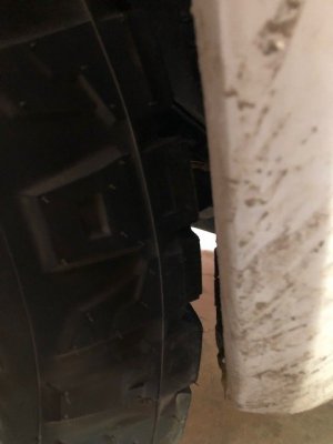

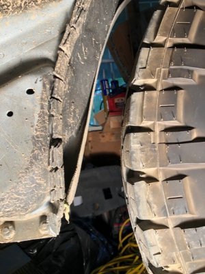

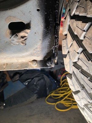

Tires have been on for a couple of week so I pulled it over the pit to fine tune any rubbing. Surprisingly there was very little. On the rears with the bed loaded down and hitting hard bumps, a slight rub on the old wheel wells that had not been cut out. Took care of that.
On the front plastic wheel wells, slight rub on the front bumper side, fixed it by pulling it back with zip ties. Double checked all the other previously items done. Re sealed the seam, made sure the main plug connection that had to be relocated was secure and secured fog lights wiring tied back better.
It's tight but no foreseeable rubbing issues. Well at least until there's a little mud caked up on the tires. I'll try to avoid that as much as possible.N&T5.jpg N&T4.jpg N&T3.jpg N&T@.jpg N&T!.jpg

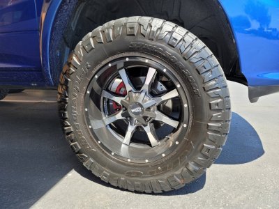

LOL! If you are referring to the tires up front, yes they are in 3" each side which works now for me for the stock set up. If I go with the Dirt King long travel lift kit, they will push the tires out 3" to match the back. So these would still be the wheels needed, I would put the 13.5 tire up front as well to match the rear.
When I was pricing out the kit, I realized the fronts were wider and you would need a 3" spacer on the rears to match them up. I'm not a fan of spacers. So for now I'm going with this look.

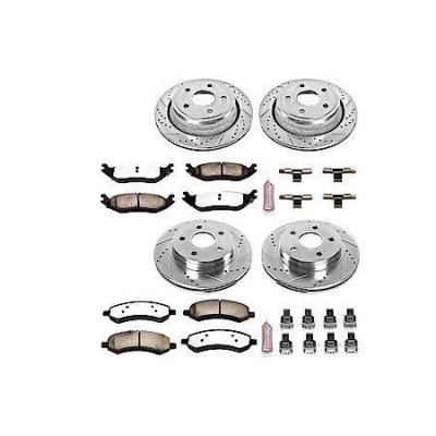

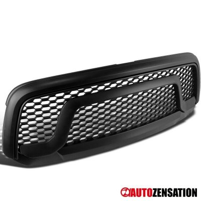

I ordered my last few body parts so that should complete the look I want for now. UnderCover UC3076S SE Smooth Truck Bed Tonneau Cover non finished, just primed & ready for paint. I couldn't see paying $500.00 more for the paint and will put that savings towards the complete paint job later.
I've de-badged it and will shave the badge on the tail gate. The grill I got has no badge so the Ram will be 100% de-badged.
I've also noticed the brakes will need replaced soon. With the 37" Nitto's adding strain to the braking system, I've ordered the heavy duty Z36 Truck and SUV Carbon-Fiber Ceramic Brake Pad and Drilled & Slotted Rotor Kit.
View attachment 249100 View attachment 249101 View attachment 249102
Excellent choice on brakes. They don't disappoint!

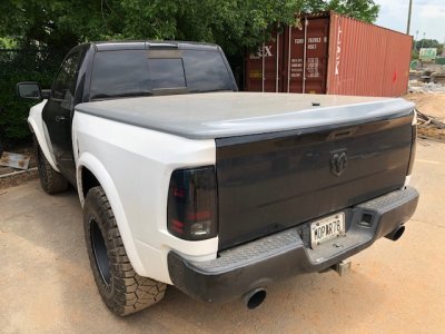

I installed the Undercover & Grill today. The grill gives it a clean & mean look in my opinion and the old one was way heavier than I ever thought it would have been so a little weight loss. The bed cover fits perfect. I was concerned a little about the fatter fenders and the fitment of the cover. I was a little reluctant about getting it because the ones that I've seen on other trucks looked too big with a 1/2" gap around the bed & cover. With these wide body fenders, the gap is 1/8" & hugs it consistently on all 3 sides. I actually slid it forward 1/4" which tightened up the tailgate with no rub or contact. I'm very pleased with it and getting 1 more step closer with the exterior look that I want. I’ll shave the tailgate badge next.

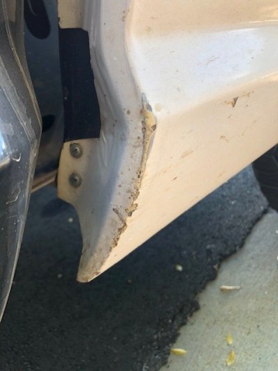

I've put several thousand miles on this wide body kit and have confirmed that the rear fenders are getting chipped from the debris coming off the front tires. I knew this would be an issue and believe I have the solution. I'm personally not a fan of the mud flaps so I'm going to try something a tad bit different. After many hours of research, I've found a Running Board that should work and compliment the Widebody kit. I just purchased the commercial grade Aries RidgeStep running board. Instead of the one for the RC SWB that was 53'' long, I ordered the extended cab which is 75" long. This will fit perfectly from wheel to wheel (wheel well that is) and give it a cleaner look. I should get it next week and install on that weekend. It has a unique bracket system that should allow it to work. I verified with the manufacturer and they agreed. Once installed I'll repair the chips and paint to confirm that it prevents chipping before I final paint it.

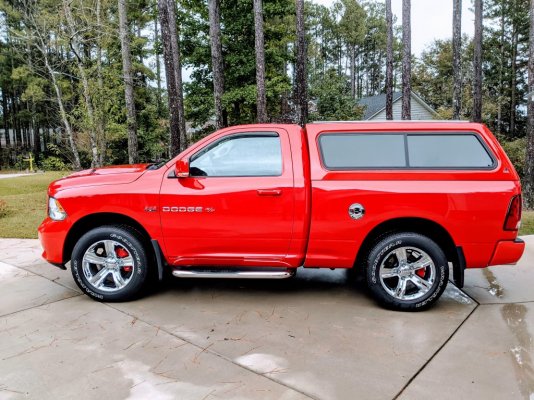

I understand what you are saying, I don't like steps or mud flaps but I have both. Sometimes you have to find the best things you can for function over looks. I don't like my paint all chipped up so I had to settle for what I have.PXL_20211010_152720683~2.jpg

I understand what you are saying, I don't like steps or mud flaps but I have both. Sometimes you have to find the best things you can for function over looks. I don't like my paint all chipped up so I had to settle for what I have.View attachment 474660
That's one super clean nice looking ram you have there!
