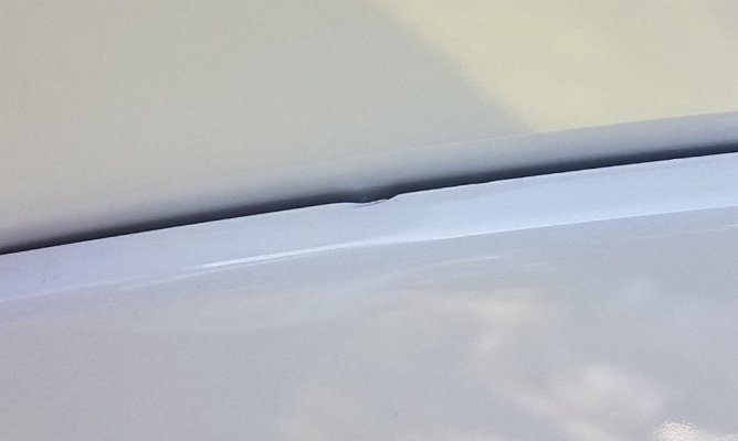

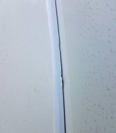

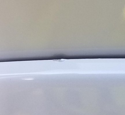

The trucks brand new 3-4 months old, curious if you guys manual has information on how to re-align the tailgate.
The dealer says no-alignment possible on my tailgate.
Also complained about my front bumper to the body, i can stick my entire hand between the bumper and headlight fairing on 1 headlight and the other I can barely get my finger tips in there.
They said it was all a optical illusion!!!
I said my driver side fender flare is painted like crap - they said nothing wrong!
Man that is BS right there. That is obviously not quality checked. Ping @ramcares and they can help you with the dealer.
Sounds like you need to go to another dealership for repairs! And I’d also start a file with ramcares on this forum.
