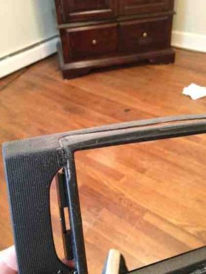

So, this weekend I decided I'm going to attempt a double din conversion...I'll try to post up pics along the way. Here's where I am do far...

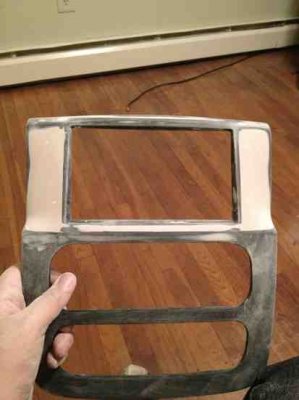

What's the best way to deal with bubbles in the filler? Will the primer fill them or should I add some filler to those areas and resand?

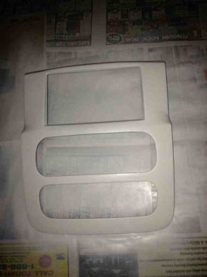

This is probably one of the coolest DIY project I've ever done
Not done with painting, but the first coat of primer is on

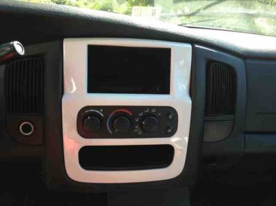

I haven't gotten to the stereo installation yet, but I thought I'd post up my final results
I need to sand it with some fine grit and really get it polished and smooth, but I need it to be drier...so it's installed temporarily till its had a few days to harden

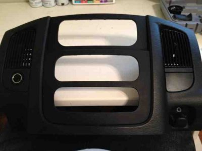

Update here... Finally got the stereo installed partially... Head units done, two out of three amps done.
Sorry for the pic quality. It was late at night Watching avengers in the truck;)
