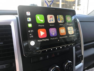

I have the Alpine ilx-207. I did not have to cut anything in my dash - 2012 Sport. It is a single din with a a double din screen. Everything fit fine!
I ended up fiber-glassing the bezel so it fit without the edge filler plates; and later painted the light sliver parts the dark grey of the 2014+ sports.IMG_20180608_072325.jpg

I also have the 2012 sport with the Alpine speakers. I was wondering if you had to buy anything else in addition to the HU to make everything work as it does now. Back up camera, sirius radio and steering wheel controls?
Thanks
Sent from my SM-G950U using Tapatalk
emjohn4
Jul 25, 2012
1,220
868
Thanks
I did...a few items:
All works as it did from the factory, the steering wheel controls, the backup camera, etc. I did set up the iDatalink module to 'disable' uconnect, but retain the factor mic; which made the bluetooth audio connection easier to use. The parking brake bypass allows input to the radio (nav) when moving, which is nice.

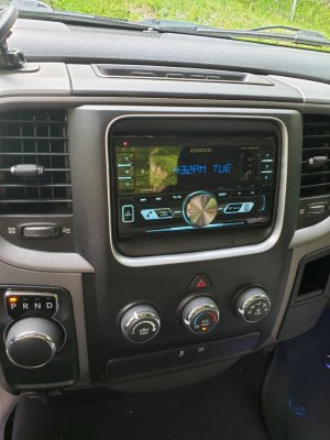

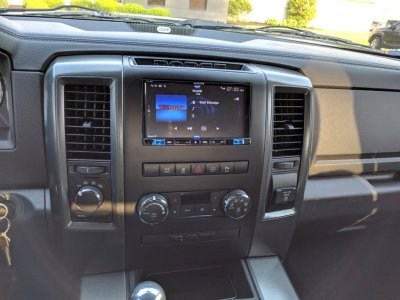

I just upgraded my factory 3.0 to a kenwood 303dpxmbt I think is the #. Taking dash apart is easy, taking the factory unit out is easy, did have the uconnect clip break, but I'm not using it so oh well. Hardest part was cutting the metal bar out. Tried some snips, would go through, hacksaw will fit in the hole, but you have to be careful not to have it gnaw on the plastic support. Did the ready harness from crutchfield so it was connect 3 or 4 plugs, hook in the mic, and put it back together. For the mic I ran it in the upper corner of the windshield, loosened up the pillar trim piece and weather stripping and tucked it behind there and ran it under the dash. Made a huge improvement to the mopar kicker speakers I have in.
