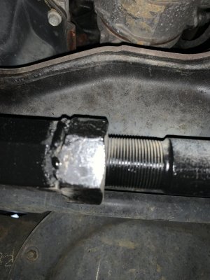

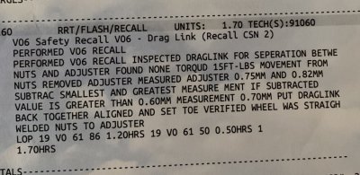

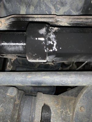

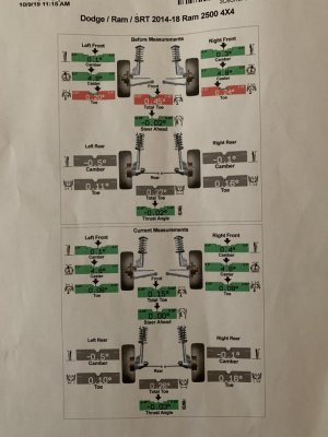

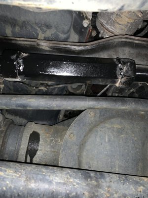

Following up on my recent post and pictures. 6-hour dealer visit and they took care of V06. Ended up disassembling and measuring...reassemble and weld. Last pic has repair order comments.
