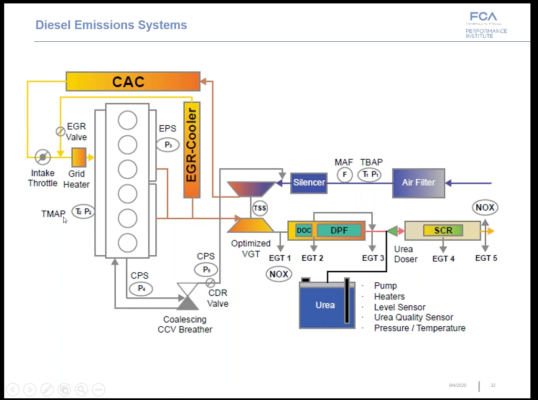

06 Dodge
Jan 4, 2022
2,916
3,546
Forest Grove, Oregon / Osage Iowa
6.7L CTD
Attached below is a diagram of the FCA diesel emission system, it shows that DEF is injected after the DPF and before the SCR:
