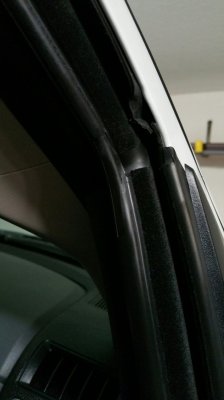

It might be the inner window seal , the rubber felt window guide that sides around the door window and goes halfway down the door. Its the inner seal. On mine the right side was cracked and folded inwards when I bought it.
