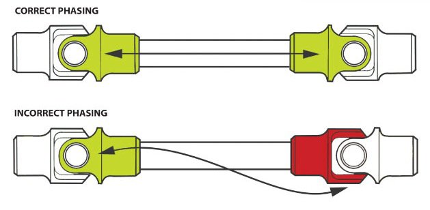

Where the driveshaft is slipped over the end of the transmission spline isn't going to matter. What you do want to make sure is the u-joints on the driveshaft are phased correctly to on each end, they should be identical on both ends.

As posted already just make sure you driveshaft is timed correctly.
