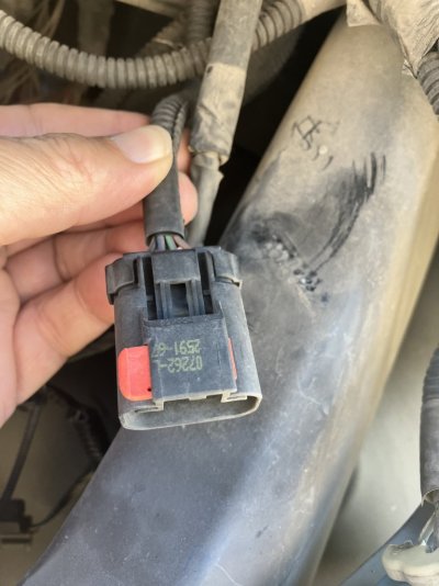

Macram02
Mar 13, 2024
Fort Worth, TX
2002
3.7
My 2002 ST 3.7L did not have fog lights, it has the relay and fuse for fog lights but I do not see the connector for the lights to connect to the main harness, this is the only connector that is not plugged into anything and its not the correct connector and I dont know what it goes to?
