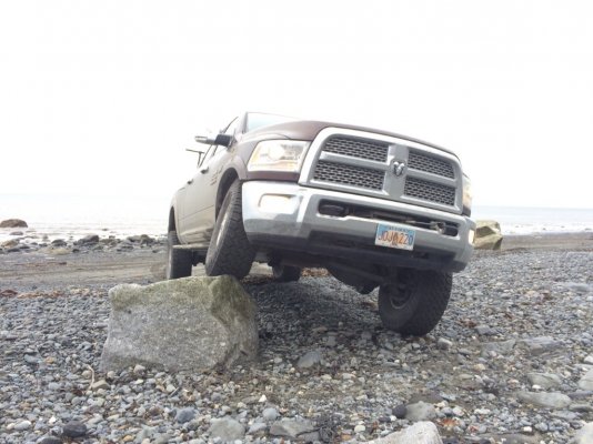

I beach my wagon occasionally. On stock duratracs, I could count on needing to air down to about 30 psi or the axles would hop badly under hard throttle (going up dunes). I’m on 35x12.5” tires now, 40 psi front and 35 psi rear and haven’t had problems with axle hop yet, but I haven’t done many beach miles on these tires either.
Our beaches are a mix of sand, shale and gravel. Mixed sand/shale is the worst.
