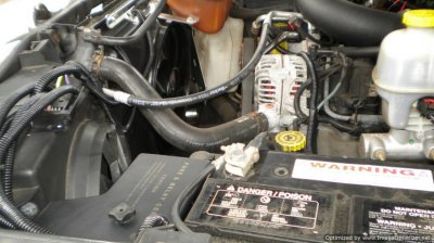

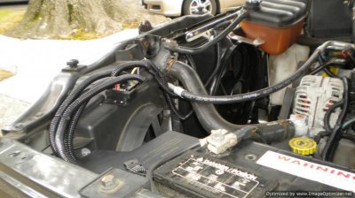

I finished putting mine into my 2003 this weekend. I worked through the troublesome roadblocks. Stuff like when the instructions say to attach a wire they forget to add in the hour it takes to remove the cable cover... But, otherwise, the instructions were very good.
Anyway, it's done. It cycles on & off after I adjusted the setpoint. Comes right on when I turn on the AC. All I have left is to modify the fuse box cover and dress the wires.
Describe your malfunction. Maybe I can offer some suggestions.

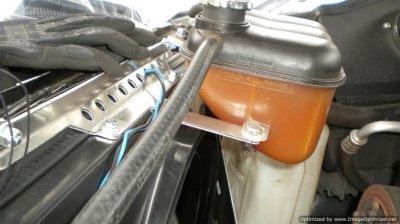

A few more pics

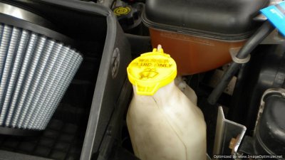

Lessons learned, tips for the next Efan installer:
1. A wire that is cut a little too long is wayyyyy better than too short. :roflsquared:
2. I used most of two packages of the split flex tubing. I got mine from Lowe's.
3. One of the pics (above) shows the window washer fluid res. I had to hack off the top spear. :superhack: I was originally concerned that it would pop out if I hit a good bump. After I put it all back together I noticed that it is kept in place between the CAI filter box and the radiator overflow tank. It's not going anywhere.
