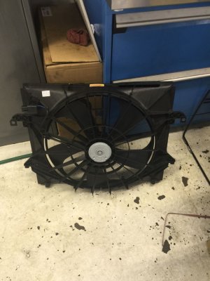

I installed my fan a few days ago. So far no problems. Throttle response has improved slightly without the mechanical fan

The fan is quieter than I expected. As long as it holds up I'll be happy. I'm not too worried about over heating. 180 t-stat and fan turn on temp at 195

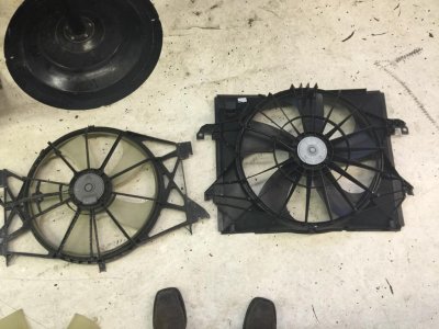

I am going to do this mod, if you look at these fans the factory fan was 9 swept blades the aftermarket ones have only 5 blades and this could be why people complain that the aftermarket ones vibrate more.
This is a good upgrade just do plenty of research to make certain it's plug and play on an 09. I have read a ton on this subject and it has stood the test of time that it works.

I bought one last night, I got a factory 9 blade instead of the aftermarket 5 blade.
