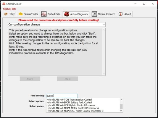

From what I understand it’s not straight forward as the starter is somehow tied into the hybrid battery pack for the auto start/stop and hybrid.
The MGU is responsible for the start in S/S mode not the traditional starter which is 12v pulling it’s power from the traditional 12v battery. The MGU produces 48v when it’s in generator mode to feed the battery pack so it needs 48v in return when it’s in starter mode. The 12v battery is charged through the battery pack not directly from the MGU. Don’t see a mod being developed to bypass this system.
