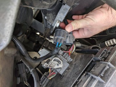

Hey guys
I was checking my oil this morning and I notice an electrical connection unplugged in the engine bay. It's on the driver's side between the radiator and fender. Nothing seems off when driving but I'm wondering what this connection is and if it should be connected. My truck is a 2012 ram 1500 4 door, 5.7hemi v8, 2 wheel drive big Horn edition. I attached a picture of connectors as well.
Thanks

Looks like the connector for the A\C condenser fan.

Thanks. I reconnected it. The clip that keeps them together seems broken so I need to get a few zip ties.
