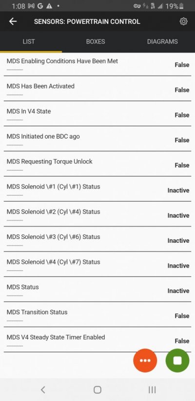

@dkelly3103 Get the JScan ($23.99) app and a Bluetooth OBD II adapter, and get a thorough readout with the engine on of your VVT, cam actuation, MDS (you need to drive for this one), and see if anything jumps out. It will show you if the cam is out of sync, or if you have any misfires, it's pretty good and detailed.
I just found that with Mobil 1 FS 0W-40 my MDS is totally disabled and the VVT system is slowed down as a precaution by the PCM. I assume it's the same for RedLine 5W-30.
Screenshot from JScan today, while driving/coasting:
