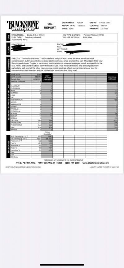

So I got my results back today. I know others have said the test won’t tell me much, but would it still be safe to say I don’t have a seized roller on the lifter since there is no abnormal wear going on? Also to those who know what there looking at, do the results in general look alright for a higher mileage engine?
I would say you dont have a stuck roller. However you added schaeffers moly ep? Moly doesnt seem to be boosted much

Alright great that’s what I was thinking. I’m leaning more towards some type of exhaust leak at this point. And yes I added Shaeffers Moly supplement, I noticed the levels were low as well so I’m not sure what’s going on with that.
Schaffer's Moly EP uses Antimony as a friction reducer, not Molybdenum. You shouldn't need to add a friction reducer to oil as good as PUP 5W-30. These premium ILSAC fuel economy oils (Mobil 1 EP, Castrol EDGE EP, PUP, Schaeffer's, AMSOIL SS) are already dialed in for peak friction reduction. The only downside to them is that they are formulated assuming that they are run in a 100% healthy engine. That's why most of these oils have a High Mileage version. My preferred version of a high mileage oil is an ACEA A3/B4 class oil. Anyway, adding Schaeffer's to it won't improve anything. Most people don't think that when they mix in additives, they might hinder the performance of a fully formulated oil, but that's the case more often than not.
