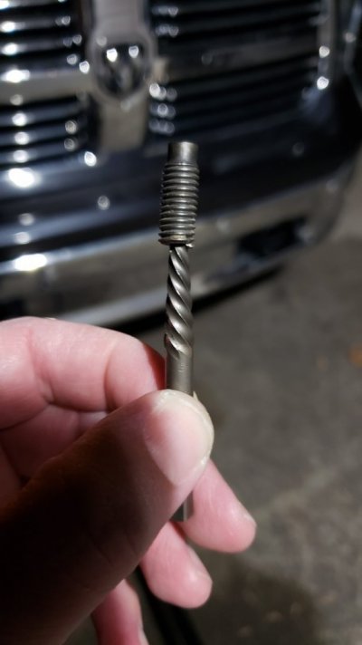

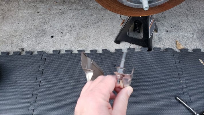

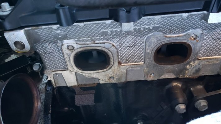

I'd encourage you to do a quick check for a manifold exhaust leak. The common broken bolt scenario can be checked on the truck when cold, from inside the engine compartment topside with the truck on the ground - might need a stool if your truck is lifted.
If heat shields are in place, a broken bolt will allow the heat shield (HS) to move (push/pull) at the rear edge. I confirmed mine this way - passenger side HS moves, driver side HS does not. I'm getting it fixed under warranty next week (57K miles on truck). If heat shields are absent, the bolt heads are visible, and with a good light you can inspect for a missing bolt head(s).
Hope this helps
